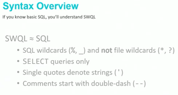

The labs indicated that SWQL is basically SQL with a few small differences, and they plaster this list:

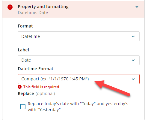

Dates are next up. Let's say you're using the Graphical Query Builder and you want to use the compact view... I mean it's listed there. Denied!
So go over to SWQL and use DateTime to format it the way you want right? Wrong you'll use DateTrunc and you'll like it!

    I have also run into the same DateTime format issue.
    As an example for , any query with a DateTime field:
    e.g SELECT TOP 10 NodeID, DateTime from Orion.ResponseTime
    • Raw output - no formatting
    • Format = Datetime. Datetime Format = Full
    • Format = Datetime. Datetime Format = Compact.  This errors out and you can't save the change.
    So your only option is the super long date format, or the default format, or format the datetime in the SWQL query itself.

    I pasted a screenshot of the error when trying to use compact format for date/time but Shuth below has a more detailed post on it below so I won't go into that one.

  • This feels like a bug for Modern Dashboards.  Has anyone opened a ticket?  If so, DM me the number and I'm happy to look into it.
  • I can confirm that the formatting of compact is OK as a JSON option
    [Option value of 0 = Compact, Option value of 1 = Full]
    This is most definitely a bug (IMHO) and someone should raise a ticket.

     This is also why I think this is a bug with the UI of the Modern Dashboard builder: definitions that exist and are formatted correctly will render, but you just can't select the Compact option from the drop down and get it to save.
