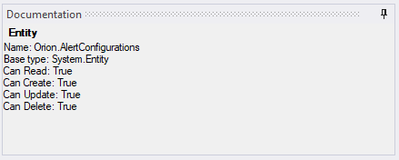

  • Orion.AlertConfigurations does support DELETE operations.
    Which means should be able to run:
    # Connect to SWIS
    $SwisConnection = Connect-Swis -Hostname "myorionserver.domain.local" -Username "MyUsername" -Password "MyComplexPassword"
    # List all of the URI's for the Alerts
    $AlertToDelete = Get-SwisData -SwisConnection $SwisConnection -Query "SELECT Uri FROM Orion.AlertConfigurations WHERE Name = 'Name of Alert I want to Delete'"
    Remove-SwisObject -SwisConnection $SwisConnection -Uri $AlertToDelete
