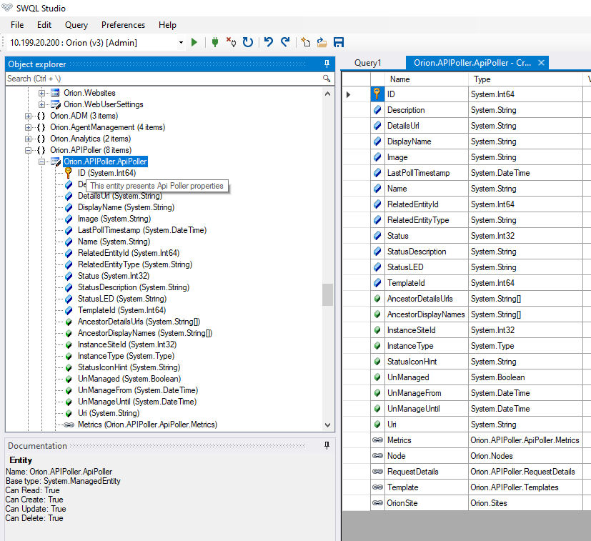

    Although I have not used the API specifically for the purposed of creating API pollers, when I look at the entity documentation in SWQL studio it should be possible as The entity support CRUD opreations

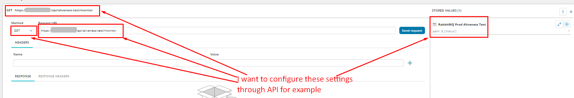

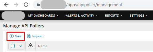

    I will try to explain my need:
    I want to use Orion API or a non-UI way to setup a new API poller:
    I hope it is more clear. Thank you in advance for your help

  • I tried to create a record on the table Orion.APIPoller.ApiPoller  by using PowerShell and it can't be done. Seems like that table can't be modified by a 3rd party app via APIs through CRUD operations.

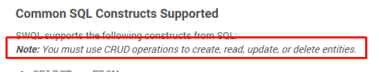

  • Exactly... but SWQL indicates the opposite:
    If the documentation is resumed by the red square in the screenshot it is a shame for a paid product like Orion... I'm very disappointed. And a bit angry because the Solarwinds support do not help me except tolding me to grab info in this forum
