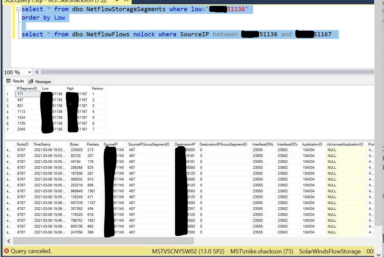

  • Did you get the answer here you were looking for?  I feel like your question is exactly what I am discovering now since upgrading to the latest version.  I was until a few weeks ago running 4.2.3 and had no problems with my query but now that Netflow is in SQL I'm having issues getting the IPGroupSegmentID's reporting properly.  Some work and return data, some do not when I know they should.
  • I don't believe its working properly via the web reporter.  In my instance I have IP Group Ranges that carry multiple IP Group Range ID's.  So when I query dbo.netflowflows and sourceipgroupsegmentid I may not be getting all of them.
  • In my instance when I run the queries below you can see that I have multiple IP Segment ID's for the same Low & High ranges.  These IP Segment ID's are all in use on the NetflowFlows table.  Querying just one would cause me to miss flows.
