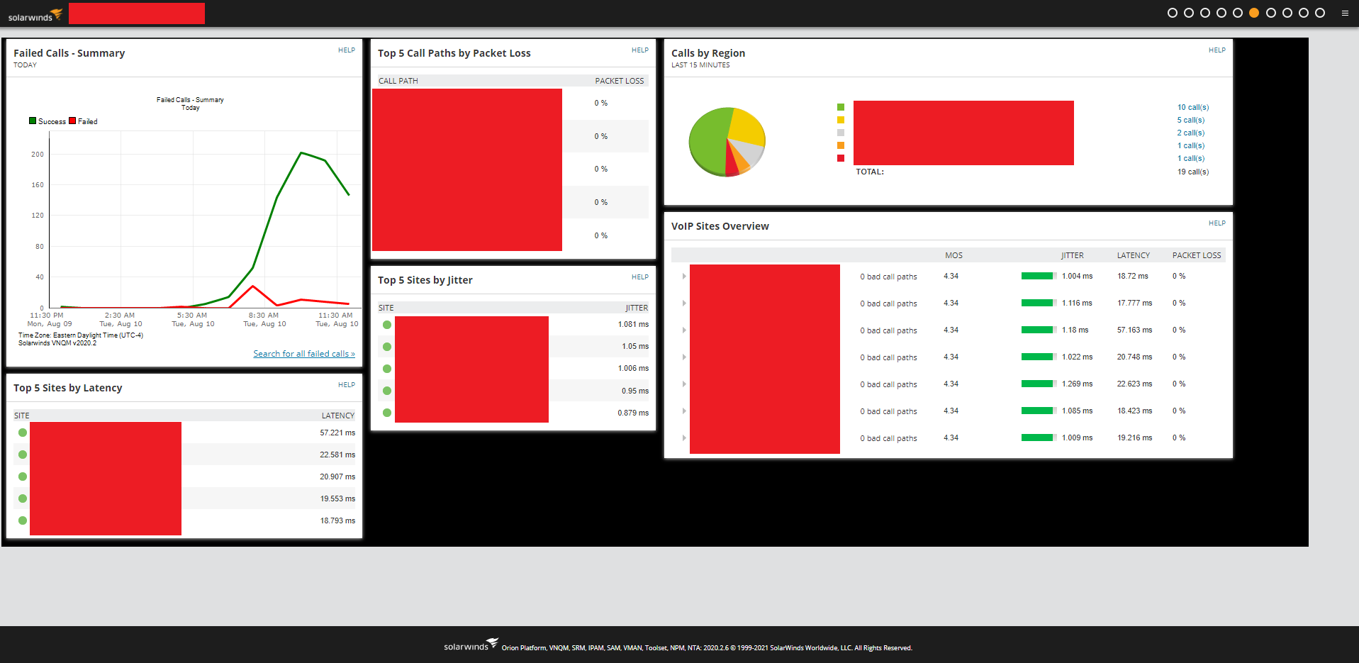

Any ideas? Individual views are fine until you're looking at them in NOC mode.

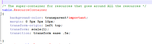

Here's the temporary fix:
background-color: transparent!important;
The table.ResourceContainer section should look like this:
