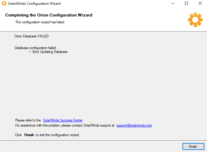

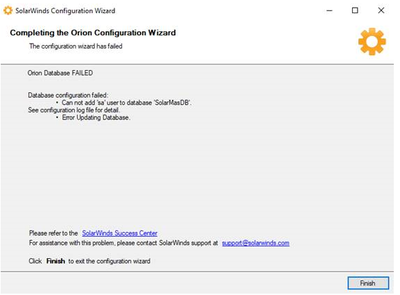

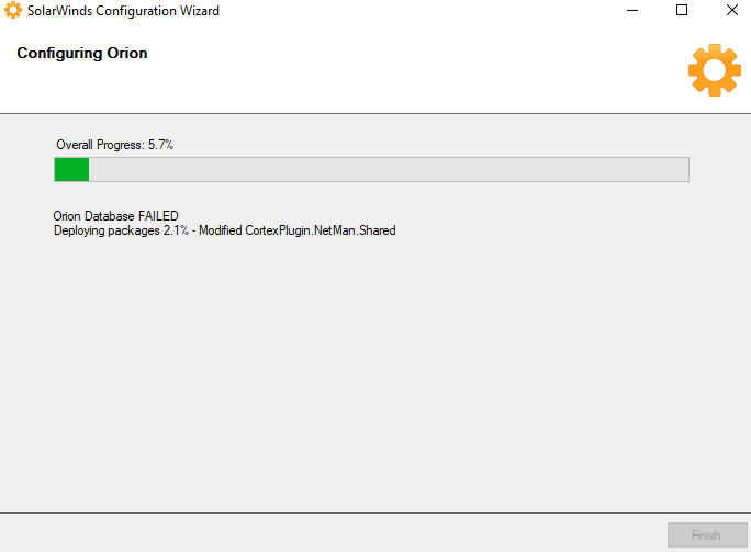

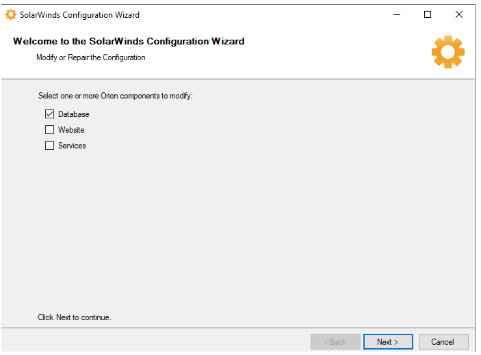

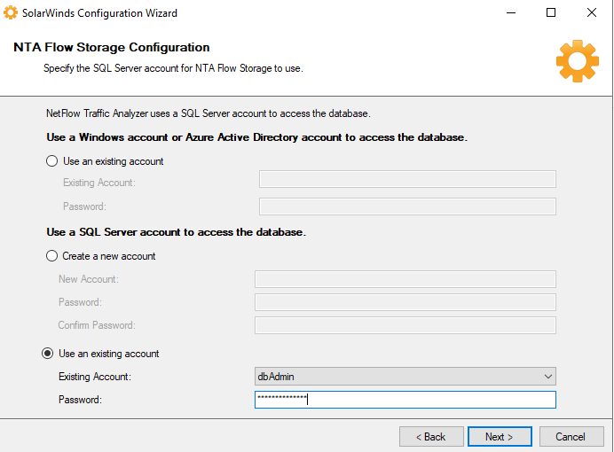

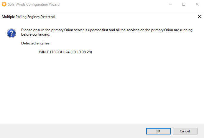

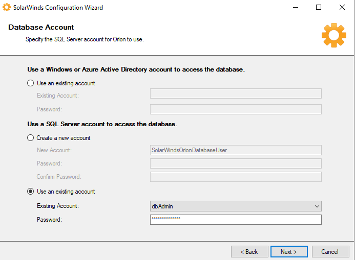

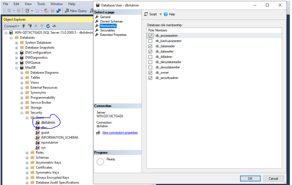

But we still get some issues when we upgrade the imported database from the old server to the latest Orion version, the Configuration Wizard seems to be hanging without completing.

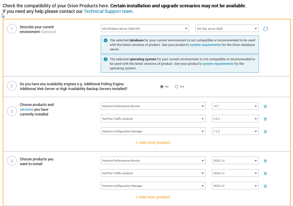

    I ran your versions through the upgrade advisor. https://customerportal.solarwinds.com/support/product-upgrade-advisor and the path to use the information in the old database took a bunch of upgrades to get the DB useable on the new install. I doubt that I would try it.

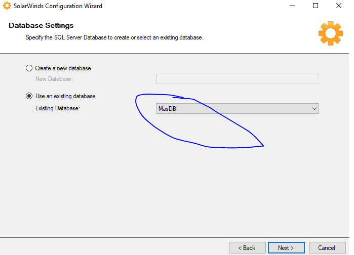

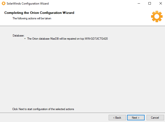

    After Installation in the new patform, we try toupgrade the imported database from the old server to the latest Orion version but the Configuration Wizard seems to be hanging without completing:
    And we create a new database is worked but I need to import my old DB in the new platform

    You are running on EOL versions NPM 10.7, NTA 4.0.2, NCM 7.2.2
    Ideally way of upgrade would have been from NPM 10.7 -> 11x -> 12.3, NTA 4.0.2 -> 4X -> 4.4, NCM 7.2.2 -> 7X -> 7.8, from here it would have been possible to do what you are trying to achieve.
    Now since the above can't be achieved, baseline is to install a fresh 2020.2.4 and reconfigure everything (SolarWinds Orion modules) from scratch.
