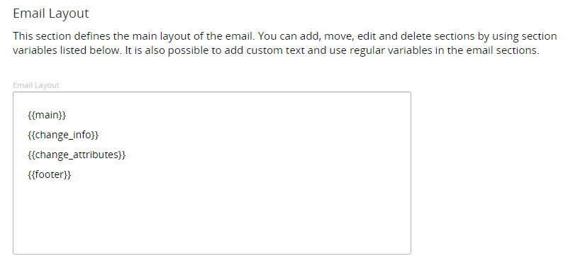

    {{change_info}} doesn't seem to be supported in the body section of a notification, but I think it should work if you were to create a custom notification based on the 'Generic Email Template' and then include {{change_info}} in the 'Email Layout' section of the template:

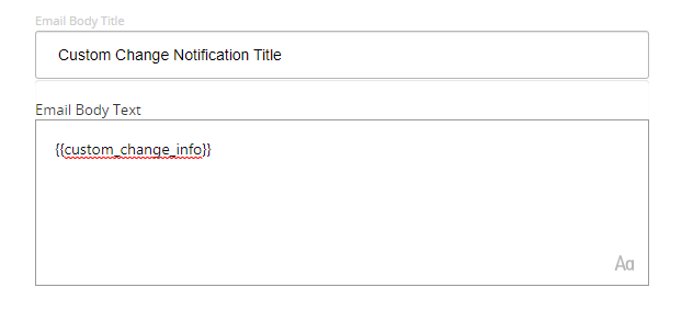

    In the Email Body Text section you could also define custom variable(s) and then provide values for them when you generate the notification from the process automation.
    In the email template:

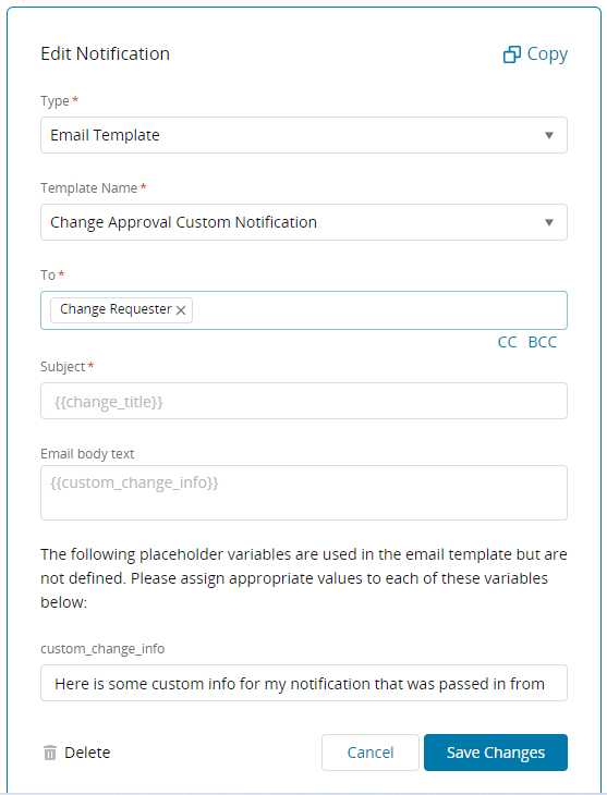

    In the 'Send Notification' dialog within the process automation:

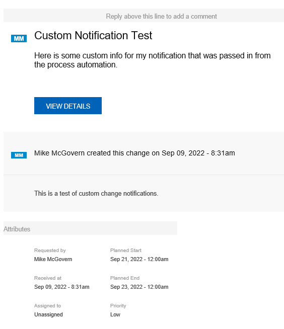

    The resulting email notification:
  • Thanks, Mike. It seems so obvious now!
