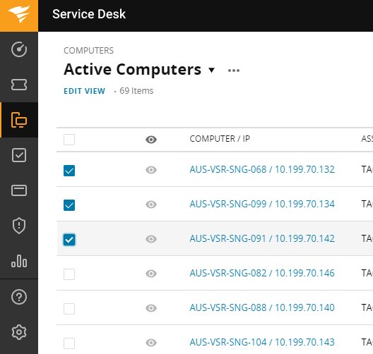

  • Hi.  From the table view of the assets in quesiton, i.e. Computers or Other Assets.  You can select one or more Assets for which you wish to print QR codes.

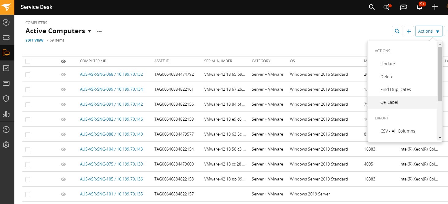

    Then, from the Action Menu in the top right, select QR Label

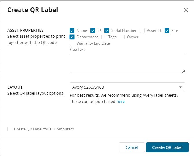

    Then you can select which fields you wish to include on the Label and print from here.
