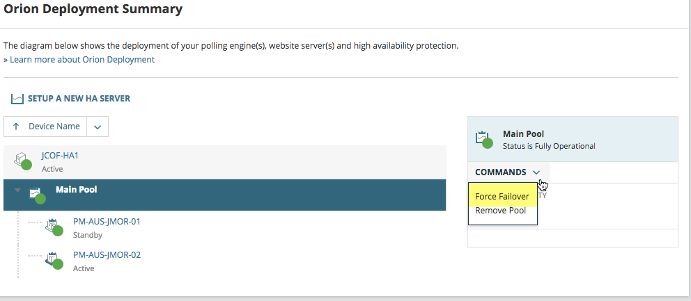

Test #4 - Force a Manual Failover
From the 'Orion Deployment Summary' located under [Settings -> All Settings -> High Availability Deployment Summary] select the Pool. From the right panel, click the 'Commands' drop down and select 'Force Failover'.

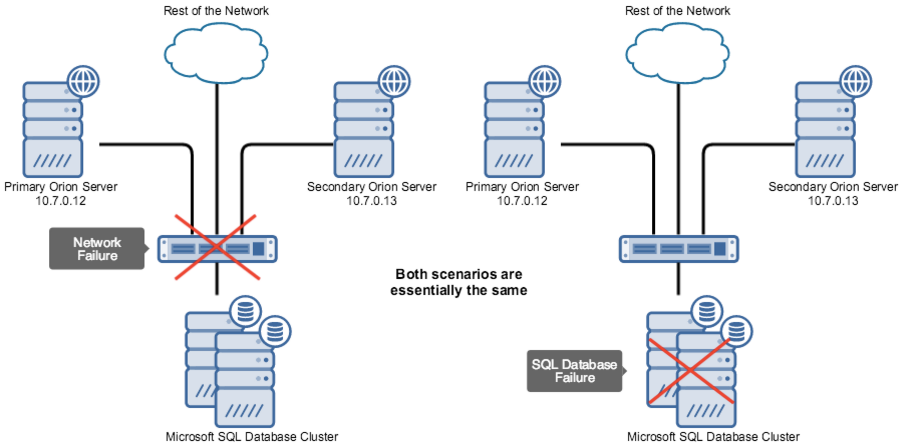

Test #5 - Catastrophic Database Failure
What to do: Power off, disconnect or otherwise cause the database server to become inaccessible to both the primary and secondary servers in the HA pool.
What to Expect: When this occurs both members are in isolation mode, meaning neither can't communicate with one another or with the database. In this situation, failover does not occur because neither member is better off than the other. Polling remains on the active member which queues its results until database connectivity is restored. The passive member remains in this state since it is neither able to communicate with the database or with the active pool member.

  • aLTeReGo​, may I please possibly confirm one scenario which I am not quite sure about expected behaviour. We have stretched subnet between 2 DCs. SolarWinds HA cluster sitting in it as well as SQL always on cluster:
    * DC1 (active poller + active SQL)
    * DC2 (standby poller + read-only SQL).
    So, my question is - what if there are some WAN related connectivity issues so that DC2 becomes isolated from DC1, but both continue to be operational. What will happen then? Will DC2 springs into live and we are potentially having 2 live instances at both ends?
  • alexslv​, split brain conditions are not possible with HA. Despite appearance, there is always a quorum to break an electoral tie. That third tie breaker is always the SQL server itself. This eliminates any possibility of both members running in isolation mode.
  • HI aLTeReGo
    One very basic question on this scenario. When the DB is unavailable for any reason. All the polling to devices will continue but the updates will be queued and pushed to DB once available?
    And where does the queuing exactly gets piled up in this case?
    So later when i pull the data it will show everything?
  • If the Database is inaccessible, the polling results queue on the polling engine they were collected from. These results are stored in MSMQ, and flushed once the SQL instance is brought back online and persisted to the database.
