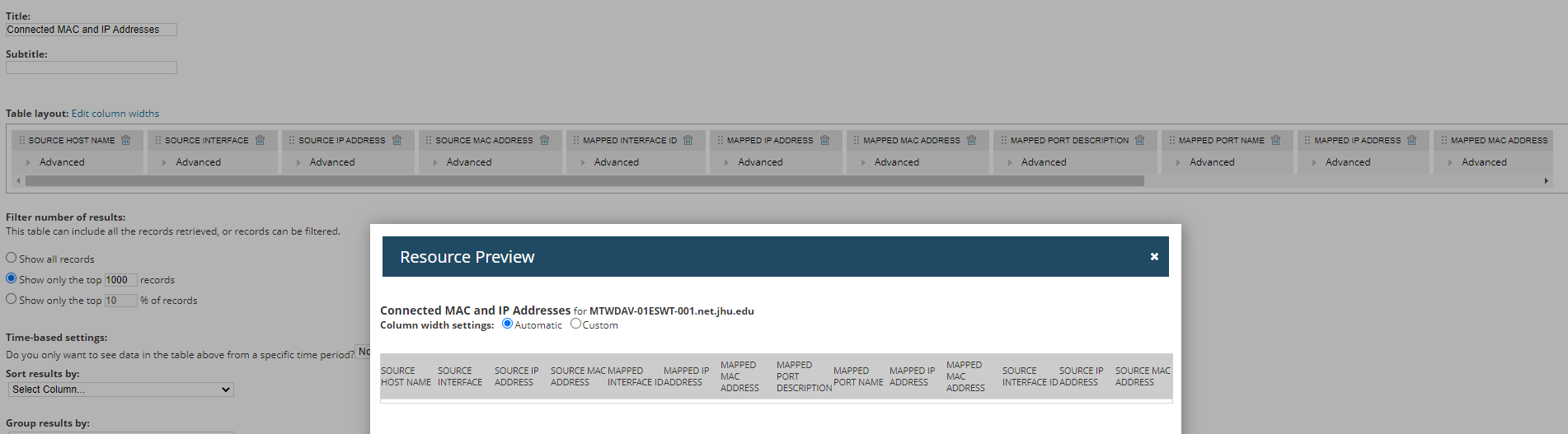

  • Thanks Bob. I'm not seeing any data populate when trying a some of those fields.

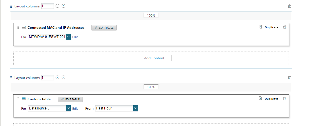

  • Hmm so that works when I use a custom query for the report data source, but doesn't seem to work when choosing specific nodes. Is that expected?
  • Looks like this data is actually from the switch not the client IP/Mac. Is there any UDT tables to pull endpoint data?
  • Here is a new query that selects all records instead of just the first 1000. That may fix your issue with selecting nodes. Also added the source mac address so you will have both the network device and client's MAC in the report.
