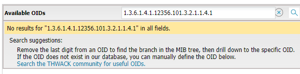

  • I have always found that you need to drop the last .x from your OID.
    So taking your CPU load as an example, then instead of 1.3.6.1.4.1.2011.5.25.31.1.1.1.1.5 - try looking for 1.3.6.1.4.1.2011.5.25.31.1.1.1.1
    I don't have any Huawei's here, but taking an OID from a device we do have e.g. 1.3.6.1.4.1.12356.101.3.2.1.1.4.1 then I get:

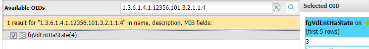

    Remove the .1 from the end and put a tick in the resultant box and I get:
