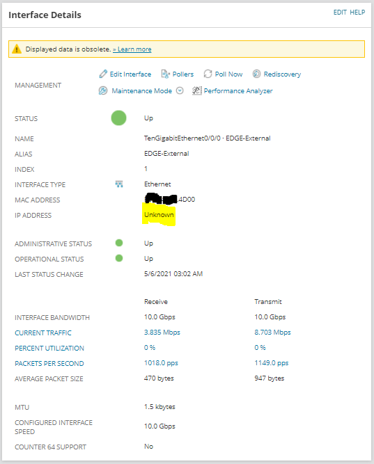

Displaying the correct IP address for an interface in HSRP configuration
We have a few routers with HSRP configurations and we recently noticed that their IP address shows as Unknown in the interface details table on the page for interface. When looking at the polling details and the OID from snmpwalk, we see that there are 2 IPs with the same integer (see below). I've opened a ticket with support and they've told me that I need to "change the IP address to interface mapping which can be done on your network so that the Orion can detect it correctly." I'm not sure where this setting is in Solarwinds or on the routers, and I was hoping that someone on here may know. Or, if you've encountered this issue before, and you know how to address it, please share the solution.
.1.3.6.1.2.1.4.20.1.2.192.168.1.1 = INTEGER: 1
.1.3.6.1.2.1.4.20.1.2.192.168.1.2 = INTEGER: 1
