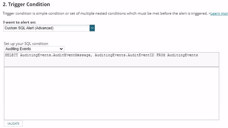

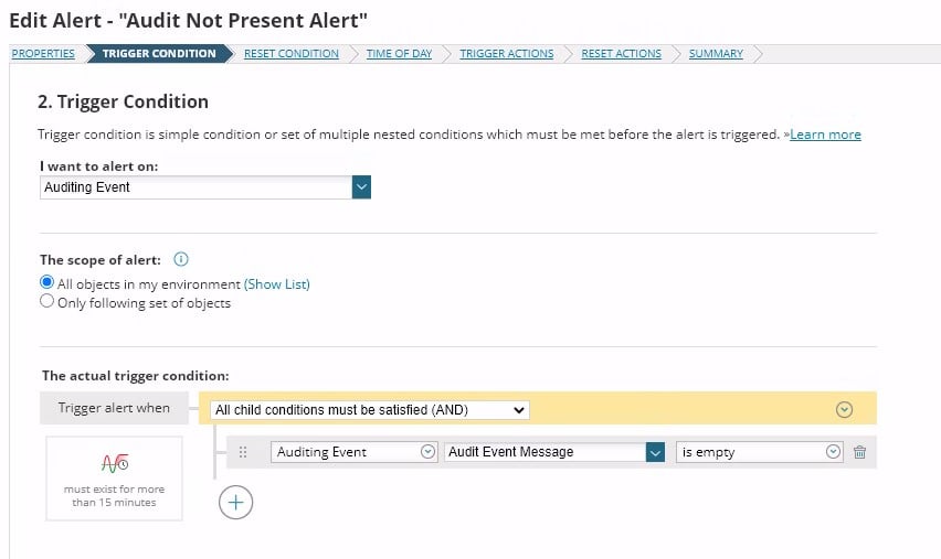

Have been working on this part.
I have set the trigger condition as below & modified the sql condition for email as below so that I'll receive alert if audit is not present for last 30 min's (including evaluation time as 15 min)
SELECT
case when count (timeloggedutc)>0
then 'Audit is present for last 30 minutes'
else 'Audit is not present for last 30 minutes'
end
FROM AuditingEvents
where timeloggedutc>(DATEADD(minute, -30, (select DATEADD(hour, -6, getutcdate()))))
