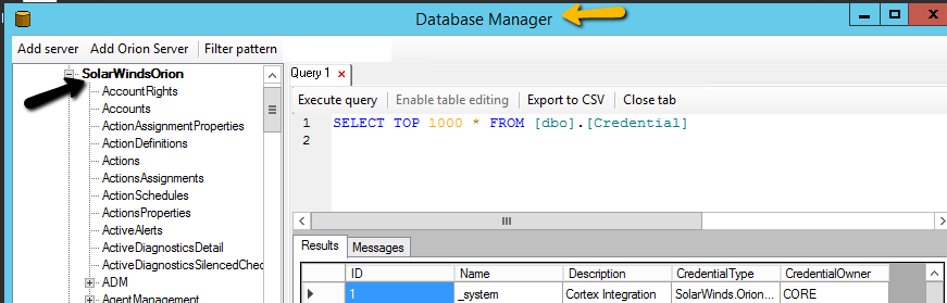

  • Hey, thanks for the reply. I fell at the first hurdle .!
    getting this when i execute the copied and pasted query.
    SELECT TOP 1000 * FROM [dbo].[Credential]
    Msg 208, Level 16, State 1, Line 1
    Invalid object name 'dbo.Credential'.
