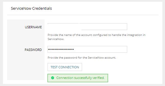

I went to the service now installation area of NPM and test the credentials, that works OK.

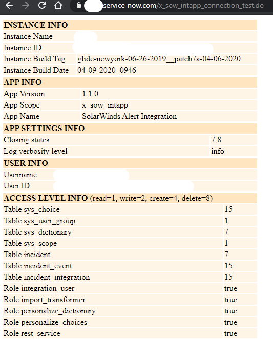

I am able to see my service now data from the main poller using this through the browser https://[INSTANCE NAME].service-now.com/x_sow_intapp_connection_test.do

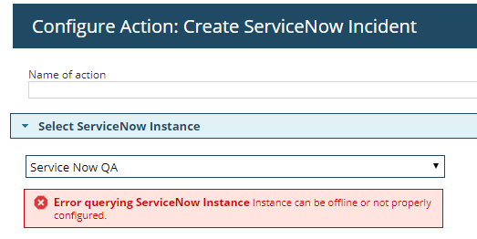

I still see the status as Down in the instances list.
I have tried disabling the instance, deleting it and re adding it, etc.  Nothing seems to work.  Can any of you point me in the right direction?
