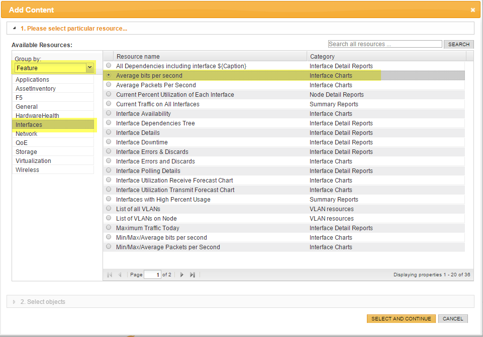

  • I'm stuck on which resource to chose. I can get some bandwidth related stats, but then it won't let me select an interface from a device. Or I can get interface stats for a whole device including all interfaces on it, but it doesn't show the right metric. There is such a vast selection to chose from, which doesn't help. Nothing I select gives me what I want so far. I've probably missed something though.
    What I want to know is which resource I need to select to see bandwidth usage throughout a given time period in bits per second. Obviously this requires a sample to be taken at certain intervals and then displayed in a graph. I know that Solarwinds has all this data, I just can't work out how to get SW to present it. Not totally enamoured with the report management interface if I'm honest.

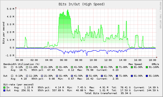

    I want the resulting graph to look pretty much identical to this:
    Obviously it won't look completely identical, as below is a Cacti usage graph. But you get the idea. These are the metrics I want to see.
    Bits per second on the X axis, time period on the Y. Samples to be taken in approx 5 second intervals (this needs to be variable also).

  • The highlighted selections will do the trick for you. It won't be every 5 seconds though as the data is not polled so frequently in the first place

  • It does let you select specific interfaces. Just change the drop down from Node to Interfaces and it will let you select a specific interface.
    assuming of course you are already monitored those interfaces. If not, from the Settings > Manage Nodes page, locate your network device and click on 'list resources' and select the interfaces you want to monitor
