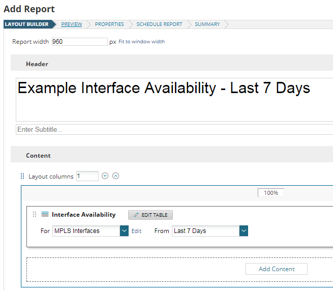

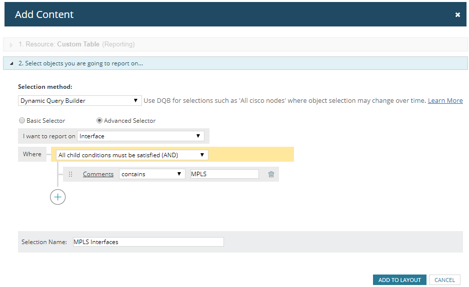

    Create a new report in the Web UI, add in a Table, where it asks you to pick your data source is where you apply filters, basically your WHERE conditions if you are working with a DBA. I'm going to use the Comments custom property but you can use whatever custom property or naming convention you need to specify the interfaces you need to look at.

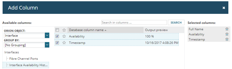

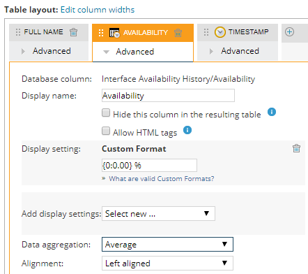

    Next pick your columns, you already stated you need a name, timestamp, percent of availability.
    For the name there's a lot of choices you could pick from here but I find that Full Name is usually the easiest way to do this.
    Next you want to get your availability stats and their timestamps, if you choose the one from the first screen you are on you would only be showing the current availability of any interface.  You want historical values so you need to click into the Interface Availability History on the left.
    So at this point is where it appears you had a misunderstanding about the data you are looking at.  Availability will always be a 100 or a 0 because at any given poll the interface was always either up or down.  The only case where you would see anything other than these is when you are looking far enough back in the history where you start seeing the hourly and then daily averaged values., on a default setup this would be after 7 days then 30.  To change from the 0/100 to an average across the whole report period you need to just tell the report to average those values across the day.
    So you can close the column chooser and click on the tab called availability and go down to the row called Data aggregation and set it to average.

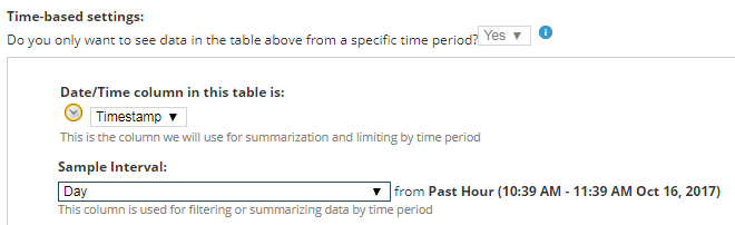

    This will give us the average across the entire time period, but if you want to get this split up into daily averages you just need to  the time based settings and tell it to have a sample interval of Day

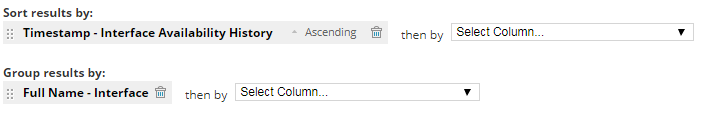

    At this point we want to tell the report to group things based on the interface, then sort them by the timestamps
    Submit the table section, give the report a name and define how far back the report will look.

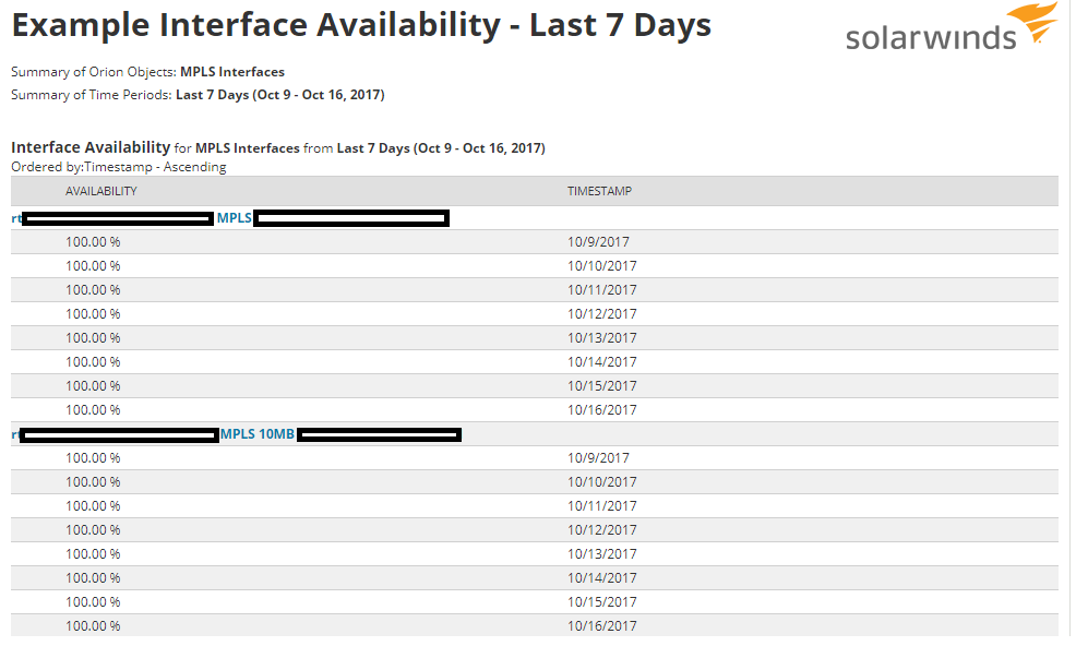

    This is what I get
    Once you know where to look this kind of thing takes about 5 min to spin up.  If I wanted I could filter it to specific business hours using the info from this KB Use Report Manager to configure business hours in web-based reports - SolarWinds Worldwide, LLC. Help and Support
