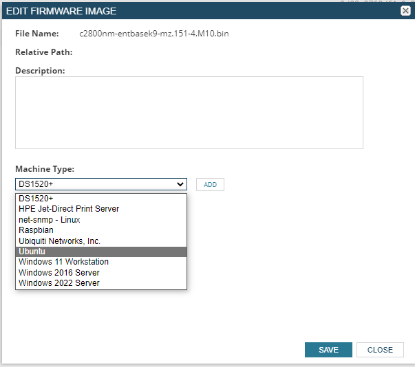

  • I think you can define the device types within the Firmware Repository definitions.

  • Very interesting. From my testing that doesn't seem to have any impact on the firmware upgrade job. I added two machine types to a specific image in the firmware repository and than attempted running a firmware upgrade job using a template which refers to the image with the machine types added. I targeted a device which is a machine type that was not listed or added to that image in the firmware repository and it executed without any warning or error that I saw up until the point that it failed in the verification checks that I put into the template.
    Since we can do verification checks before the reload occurs we can catch these problems when the job eventually errors but it would be alot better if the firmware image was restricted so a job or template using that firmware image could not run/target a machine type which is not allowed.
    thank you for the response by the way I was very excited to try it! Do you think that I should put a support ticket in as this should be limiting what devices are targeted or that adding the machine type to the firmware image is used for some other purpose? Let me know your thoughts when you have time or if you have any other ideas. Thank you in advance!
