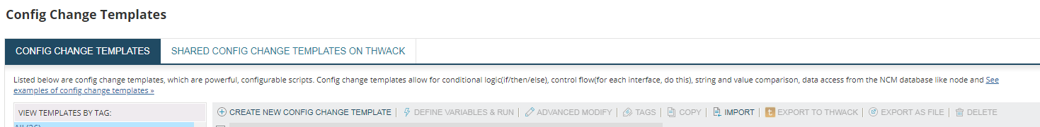

    The AgentIP is a solarwinds entity.The script is a regular config change template. You can find some predefined in your ncm installation and even more here on thwack which you can import directly from the ncm webconsole.
    You can find the documentation here: Config change templates
