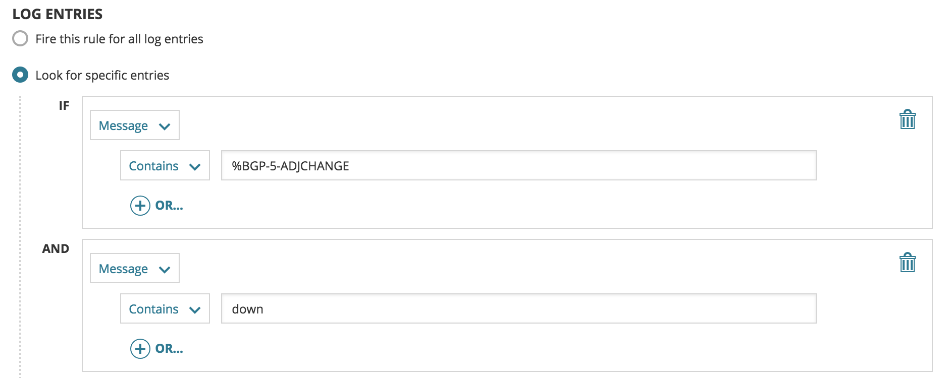

I've created a rule to monitor for syslog which contains '%BGP-5-ADJCHANGE' and 'down':

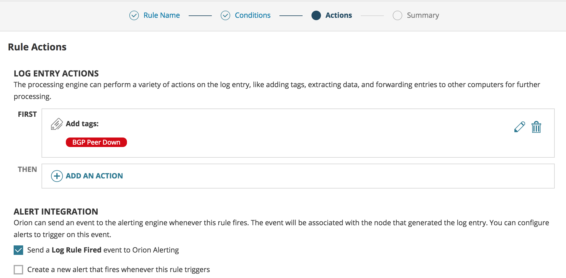

In addition to adding tags, running an external program and discarding messages, LA includes an option to 'Send a Log Fired event to Orion Alerting'. Enabling this option creates an event which Orion Alerting can use to trigger an alert.

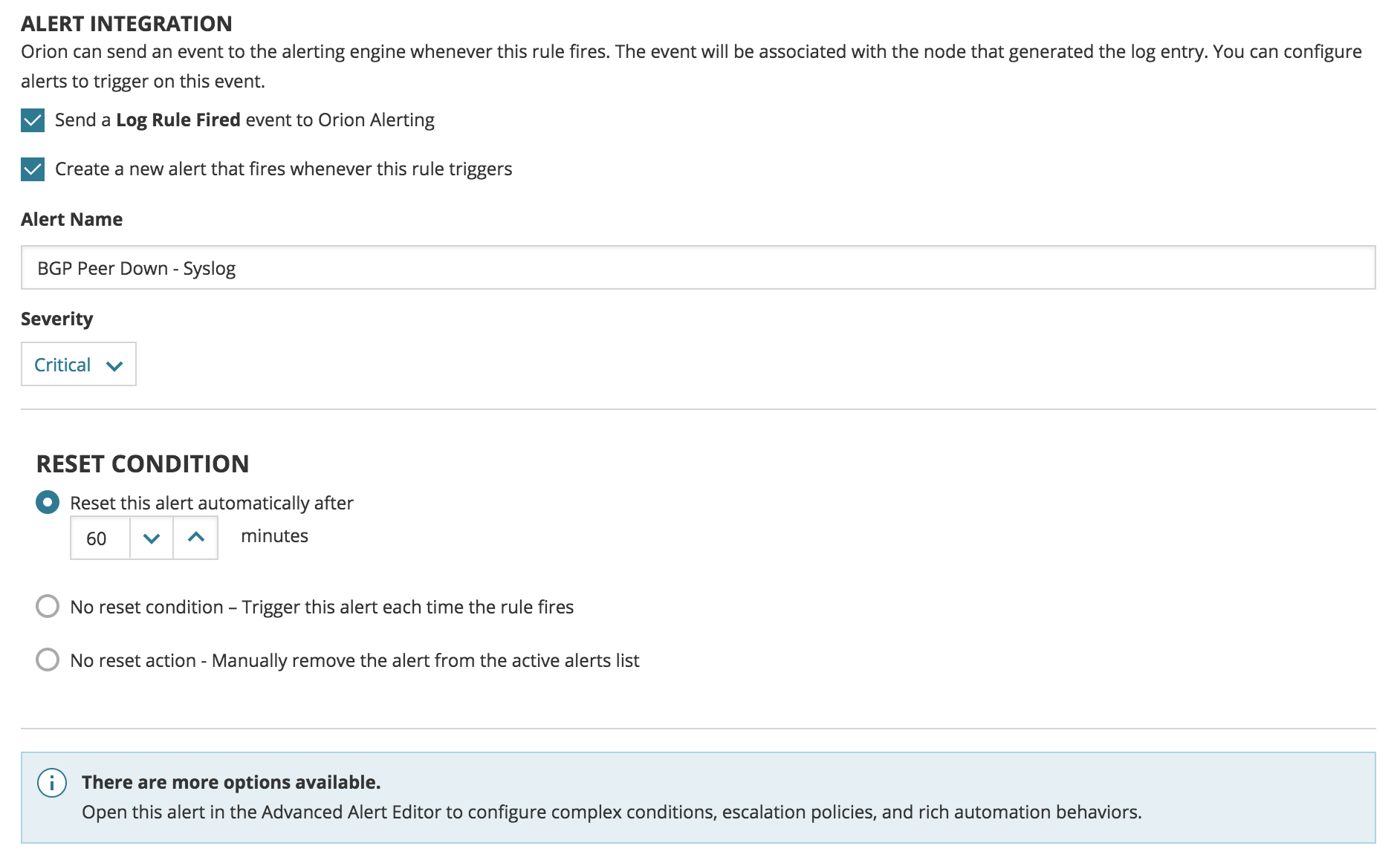

You can create the alert directly from the Log Rule configuration. Options are limited to assigning a name to the alert, setting the severity and reset conditions. In order to add additional conditions, time of day sets and trigger actions you'll need to do this from the Orion Alerting configuration. We've made it really easy to access the alert, which I'll walk you through shortly. Once you've created the alert, it behaves in the same way as any other Orion alert.

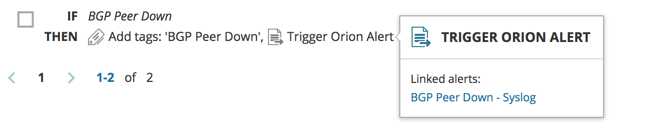

In order to access the Orion Alert that you've just linked to your rule, you can do so by clicking on 'Trigger Orion Alert' on the Rule Summary page. From here you can then add additional conditions and actions. Worth noting that you can assign multiple alerts to one log rule. If you have multiple alerts assigned, these will be displayed in the 'Linked Alerts' also.

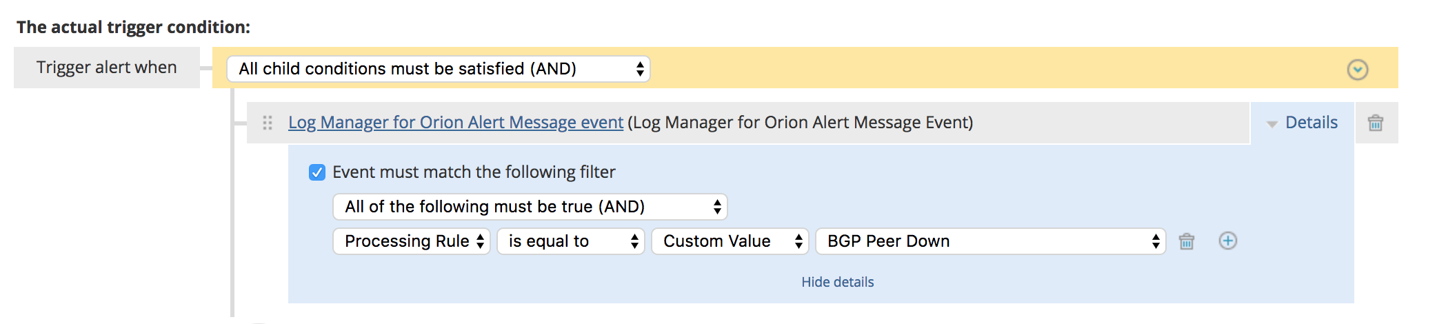

The trigger condition will look like this. You can add additional conditions here if you wish:

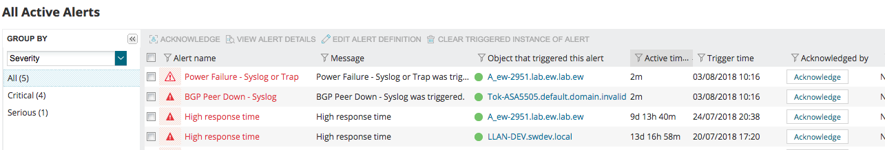

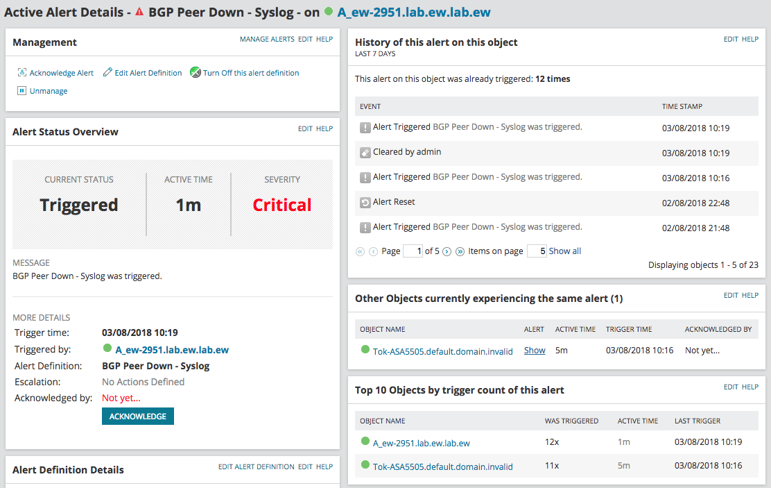

When your alert triggers it will be displayed in the 'All Active Alerts' resource along with all with all your other Orion Alerts, whereby you can acknowledge alerts, view alert details and clear the triggered instance of an alert.
You may be wondering what happens if an alert triggers but the same syslog or trap keeps coming into LA. In that scenario, the alert is aggregated for a one minute time span. This ensures that you don't get bombarded with alerts/e-mail notifications each time a Log Rule fires. You can view the number of times the alert has triggered over the last minute within the 'Top 10 Objects by Trigger Count of this Alert' resource on the Active Alert Details page.
