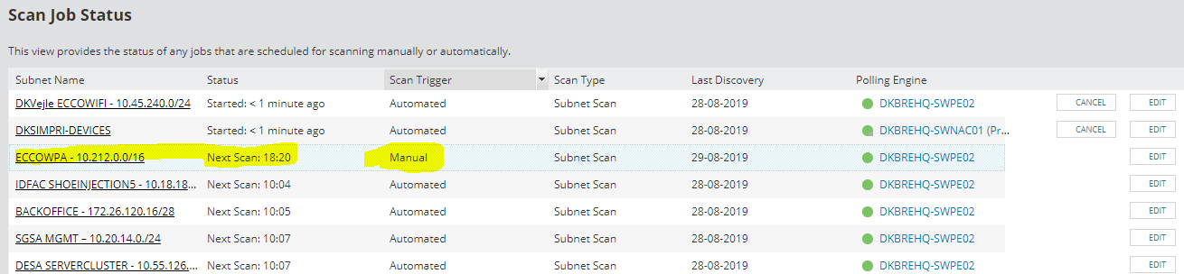

I have an issue with my IPAM 4.8.0 utilizing the additional scanning engine feature, as my primary engine is used for other workloads.
When I try to initiate a manual scan of a subnet, the scan is not started, but queued with a start time of the original scheduled scanning.
Scheduled scans are working fine.
Please see attached screenshot for clarification.
How to fix?
