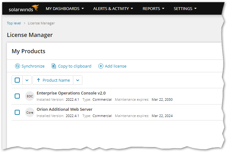

  • , I do work for SolarWinds but in a non-support role. I have EOC running in a lab so i spun up a fresh VM and I was successfully able to add an additional web server to it.
    You can find the web server installer by logging into your EOC web console and navigating to Settings > All Settings > Web Console Settings. You'll see a 'download installer now' button in the upper right corner of the screen. Transfer that installer to another Windows server that you want to stand up as an additional web server and follow the installation prompts.
    Depending on your licensing it might require an additional web server(s) license.
