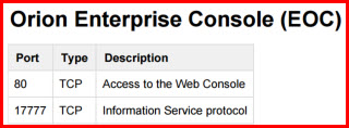

    Things to remember when checking if the relevant ports are open between EOC and the target Orion server(s):
    EOC needs to be able to access the remote Orion server via TCP 17777 to be able to display the remote instance's results. Port 80 is needed so that the remote Orion Web Console can be shown to users when a link is clicked within EOC.
