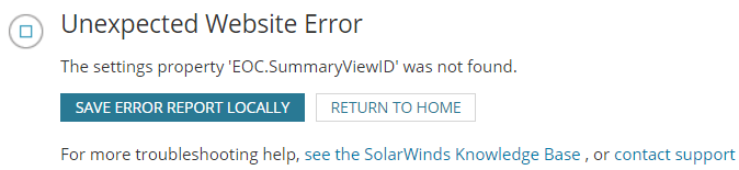

  • Upgraded to EOC 2.1 this morning.  Now staring at at this error message or similar messages when attempting to access various sections of the web console.  On hold waiting for a support resource to troubleshoot.
