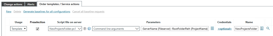

  • Thank you Emanuel,
    We are using this to 'join up' the parameters from the template to the Powershell script

  • Hi James,
    have you configured an account in the Credentials property in the script config? The labeling in that section is misleading (it says if you dont put in an account it will use the AD service account but that is not true, it will actually use SYSTEM which could explain your issue).
