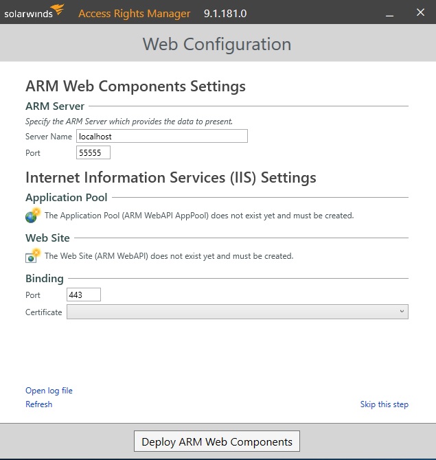

So I got the base url fixed, but I am still having issues with the web config. It keeps stating my AppPool and other IIS objects aren't there. Shouldn't the application build these by default in IIS? If not, I cannot find any documentation explaining what needs to be done in IIS Manager to fix this issue. I am not a webmaster, so IIS is not my strong suit.
Thanks in advance!

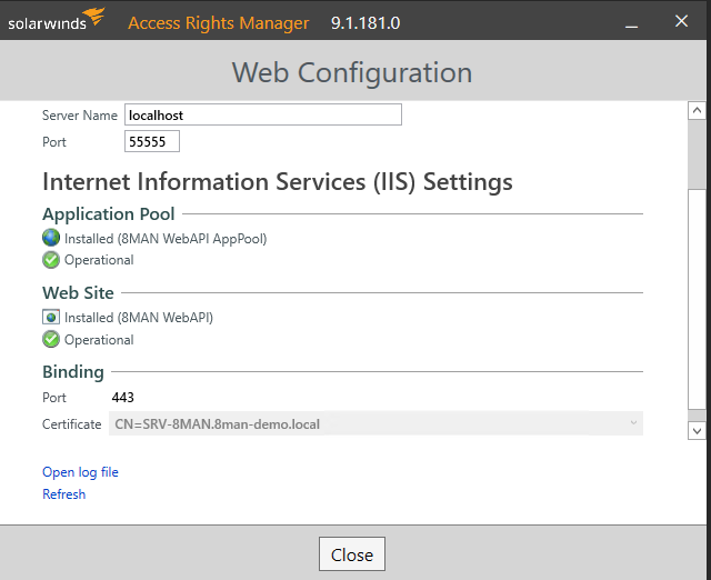

have you executed the ARM - Web Configuration? If not follow the description below.
First you have to install an ssl certificate in your IIS console under "Server Certificates". Once that is installed execute the web configuration, select the certificate from the dropdown selection under "Binding" and click "Deploy".
After that the status indicator for Application Pool and Web Site should be green and the web interface should be working:
If you have done this initial configuration already and it still doesnt work you should probably contact support.
I never get the Application Pool Installed/Operational or the Web Site Installed/Operational.
as i said in my previous post you have to install a ssl certificate in your iis console first and deploy the components.
Here is a tutorial to creating a self signed certificate which you can use for the configuration: How to Create a Self Signed Certificate in IIS | About SSL
After you have done that click on "Refresh" in the Web Configuration, select the certificate from the dropdown under "Binding" and then click "Deploy ARM Web Components"
