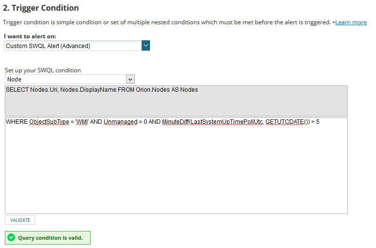

  • For availability, taking SAM monitors and wrapping them up into a group or group of groups along with the SQL query for components with problems (targeting things as appropriate) might be your best bet to make this an easy at a glance informational tool.
